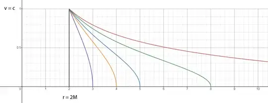

The following chart shows the speed $V$ of a free falling object as measured by hypothetical stationary observers hovering at the radius $r$ (where $\dfrac{dr}{dt}$ is from above and the expression in parenthesis is due to the hovering coordinates):
$$ V=-\dfrac{dr}{dt}\,(1-\dfrac{2M}{r})^{-1} $$
You can see that the speed $V$ of any free falling object always approaches the speed of light ($c=1$) at the horizon $r=2M$ regardless of the initial speed or at what distance the fall starts:
