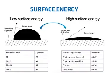

It's because of surface energy
You can just cover glass with a thin layer of material that has low surface energy (like teflon) and then water/stuff won't stick (will stick a lot less) to it...
Check this surface tension article on Toppr for much more information.
