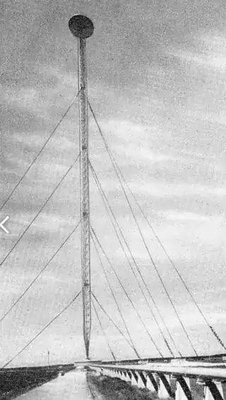

For very low frequencies it is impossible to built such long antennas. But it’s helpful to add to the end of the rod additional metal which works like a capacitor Dachkapazität (available only in the German wiki). So the acceleration of photons lasts longer and the efficiency of the generator and the quality of the wave is improved.
enter image description here Source
