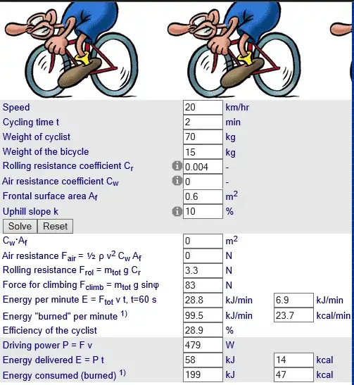

You are leaving out a lot of variables, in particular air resistance (calculations here):
For example, in going from 7.5 mph to 20 mph:
  1. mechanical resistance increases by 225%
  2. rolling resistance by 363%
  3. air resistance by 1800%.
and also how efficient the body is converting energy. According to another Physics.SE answer this is about 20% - see : How efficient is the human body?
Now ignoring all that and assuming air resistance is zero, the energy required to move the cyclist (and bike) is the same as the energy burned by the cyclist and nothing else (inertia for example) is involved then you should be looking at around 14 kcal.
There is a nice calculator here where you can check against your calculations.
