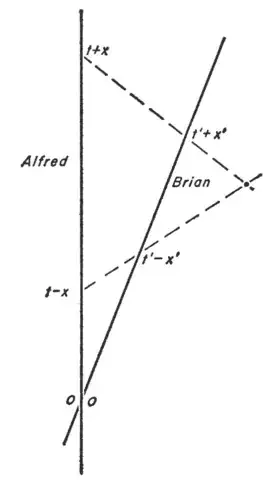

  • A good motivation is a radar measurement of an event $P=(t_P,x_P)$ not on your worldline.
    Suppose you are an inertial observer.
    To measure event $P$, imagine sending a light signal to $P$ and waiting for its echo, and noting the time on your wristwatch when you sent it $t_{send}$ and when you receive it $t_{rec}$. From those two times, you would assign event $P$ the following coordinates:
    • time coordinate $t_P=\frac{1}{2}(t_{rec}+t_{send})$ [the midway time during the round trip]
    • spatial coordinate $x_P=\frac{1}{2}(t_{rec}-t_{send})$ [half of the roundtrip time (multiplied by c)]
    Note that $t_{rec}=(t_P+x_P)$ and $t_{send}=(t_P-x_P)$.
    Consider another inertial observer who met you when your wristwatch read zero and they set their wristwatch to zero. They would make analogous measurements of event $P$.
    Thus, note that $t'_{rec}=(t'_P+x'_P)$ and $t'_{send}=(t'_P-x'_P)$.
    Taking an image from Bondi's "Relativity and Common Sense"
    from Bondi's book
    It turns out for events joined by a future-directed light-signal
    that $t'_{send}=K t_{send}$ (where $K$ is a proportionality constant
    [which depends on the relative velocities of the observers]) and
    that $t_{rec}=K t'_{rec}$ (the same proportionality constant).
    (This is actually the Lorentz Boost transformation.)
    So, it turns out that while $t_P\neq t'_P$ and $x_P\neq x'_P$, it turns out
    that $$t_{rec}t_{send}=t'_{rec}t'_{send}.$$ (This is the product of times formula [seen in Robb and in Geroch].)
    Expressing this back in terms of the $t_P$s and $x_P$s, this says
    that $$({t_P}^2-{x_P}^2)=({t'_P}^2-{x'_P}^2).$$ (This is the invariance of the square-interval.)

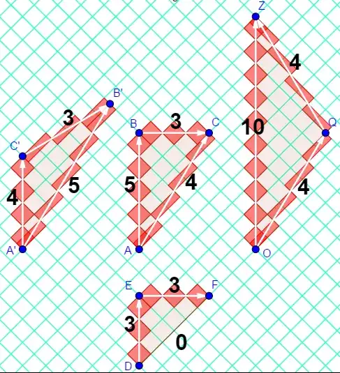

Let's consider the (1+1)-dim case and write $$S^2=\Delta t^2-\Delta x^2=(\Delta t+\Delta x)(\Delta t-\Delta x)=\Delta u \Delta v.$$ I'm going to define quantities $u=t+x$ and $v=t-x$
called (up to sign and scaling conventions) "light-cone coordinates" since these are coordinates with axes along the light-cone.

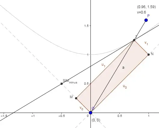

Written in this way $S^2=\Delta u \Delta v$ looks like the "area of a diamond" ( a parallelogram whose sides are parallel to the light cone). One corner could be taken to be the origin and the opposite corner traces out a hyperbola (the Minkowski-circle, the curve of constant interval from the origin) as you do a Lorentz boost-transform. (Recall that for a point $(x,y)$ along the hyperbola $xy=1$, a rectangle with corners at $(0,0)$ and at $(x,y)$, with sides parallel to the x- and y-axes, has area 1.)
Some important features of the Lorentz boost-transformation in (1+1)-Minkowski spacetime.
  • It has a determinant of 1. So, it preserves areas.
  • It has eigenvectors along the light-cone (this is the invariance of the speed of light).
  • The eigvenvalues are $k$ and $1/k$ (since the product is equal to the determinant).
    (It turns out that the eigenvalues are the Doppler factors.)
So, under a boost-transformation
these diamonds transform (are reshaped) into other diamonds with the same area.
Check out my visualization: https://www.geogebra.org/m/Jq4jDMRW Light Clock Diamond - robphy
I exploited this "area of a diamond" to visualize proper time along an inertial worldline and developed a method to do calculations on "rotated graph paper".
Check out my visualization: https://www.geogebra.org/m/HYD7hB9v Relativity on Rotated Graph Paper - robphy
The idea is written up here:
"Relativity on rotated graph paper"
American Journal of Physics 84, 344 (2016); https://doi.org/10.1119/1.4943251
