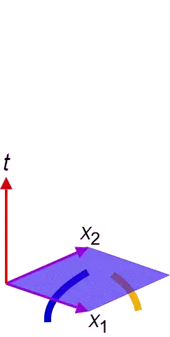

Now to the physics! What does the physics care about loops in ${\rm SO}(D)$? Let $t$ denote the time. How can we describe the exchange of two particles? The answer is by a curve $\gamma : [0,1]\rightarrow {\rm SO}(D)$ that describes the rotation of the two particles in the center-of-mass frame. This is a loop, because a full rotation of $2\pi$ is equivalent to doing nothing. Therefore, the number of topologically distinct loops is in fact the number of the different statistics possible. See also the following beautiful illustration taken from this Wikipedia page.
Anticlockwise rotationClockwise rotation
Anticlockwise rotation $\qquad\qquad\qquad$ Clockwise rotation
To quote the caption of this figure from Wikipedia
Exchange of two particles in $2 + 1$ spacetime by rotation. The rotations are inequivalent, since one cannot be deformed into the other (without the worldlines leaving the plane, an impossibility in $2D$ space).
