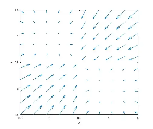

Let's plot vector field (I publish picture for smaller bin number):
figure()
quiver(x,y,dx,dy)
xlabel('x')
ylabel('y')

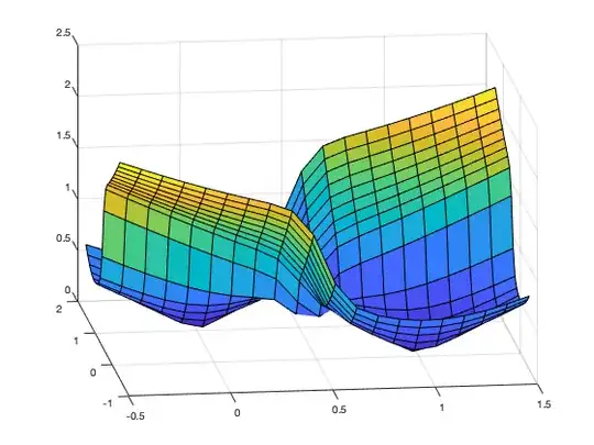

You may see, that I have a symmetric field (no surprise with symmetric parameters), where I have two stable wells at (1,0) and (0,1), two hills upper-right and lower left corners, and an unstable saddle in (0.5,0.5). Now I just want to visualise this landscape in 3D. The first (even I understand, that incorrect) approach, just to plot absolute values of velocities (speed):
Z = sqrt(dx.^2+dy.^2);
surf(x,y,Z);
Almost perfect picture, but at the point (0.5,0.5) I have stable well, instead of unstable saddle.

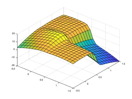

Now I try to integrate the field:
Z = cumsum(dx,2)+cumsum(dy,1);
The result is ugly: it has no symmetry, no wells...
Could You help me to find a mistake?
Hope, I just integrate in a wrong way...

Drawing a potential landscape "like it is done for gravitation" requires a second-order differential equation, of the form \begin{align} \frac{\mathrm d^2}{\mathrm dt^2}x(t) & = f(x(t),y(t)) \\ \frac{\mathrm d^2}{\mathrm dt^2}y(t) & = g(x(t),y(t)). \end{align} Your system of equations does not have this form, so the concept of a potential landscape does not make sense for your system.

EDIT: Note that in the revised question, the OP is effectively calculating and plotting $|\mathbf{f}|$ in the first surface graph. In the second, they are effectively calculating $$ g(x,y) = \int_0^x f_x(x', y) dx' + \int_0^y f_y(x, y') dy'. $$ If the potential $U$ exists, it could be found via a similar technique, but the integrals would have to be subtly different; you'd have to have $$ U(x,y) \overset{?}{=} \int_0^x f_x(x', 0) dx' + \int_0^y f_y(x, y') dy' $$ or $$ U(x,y) \overset{?}{=} \int_0^x f_x(x', y) dx' + \int_0^y f_y(0, y') dy'. $$ These two quantities correspond to taking $\int_{(0,0)}^{(x,y)} \mathbf{f} \cdot d\mathbf{r}$ via the points $(0,x)$ and $(0,y)$, respectively. But for $U$ to be well-defined, these two quantities to be equal; and for that to happen, you have to have $\nabla \times \mathbf{f} = 0$, which you don't have in this case.
