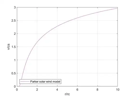

Parker's original model was essentially a simple radial speed model, derived from Euler's equation, the continuity equation and the speed of sound.
In dimensionless units:
\begin{align} z^2-2ln(z)=4(ln(x)+\frac{1}{x})-3=f(x) \end{align}
where $z=\frac{v}{c_s}, x=\frac{r}{r_c}, c_s^2=\frac{\partial p}{\partial \rho}$ and $ r_c =\frac{GM}{2c_s^2}$
This can solved using lambertW functions: Using substititions $z \rightarrow exp(w)$ and $y \rightarrow 2w+z$ one can show that:
\begin{align} z &= \sqrt{-W_0(-exp(-f(x)))} \space (x<1) \\ z &= \sqrt{-W_{-1}(-exp(-f(x)))} \space (x>=1) \end{align}
Using different Lambert function branches 0 and -1 depending on the argument; the,-1 branch is used when the argument -1/e<x<0. A graph showing the output for the 2 branches is show below.
