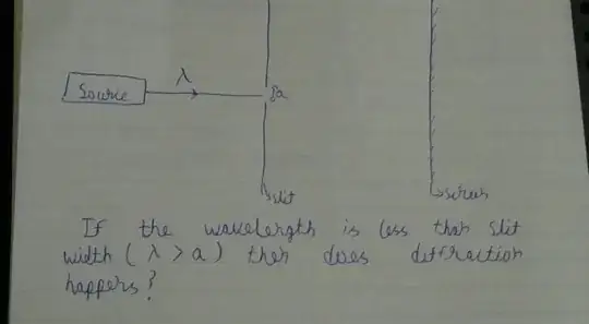

I always learnt in school that diffraction and interference happens if the slit width is of the order of wavelength. But what if the slit width is less than that of wavelength. Does diffraction happens in such conditions? If so then is there a mathematical representation for that?enter image description here

The angle of diffraction $\theta$ can be approximated by $$\theta \approx \frac{\lambda}{d}$$ where $\lambda$ is the wavelength and $d$ is the width of the slit.
Now in case of $d<\lambda$, i.e. $\frac{\lambda}{d} > 1$, $\theta$ continues to remain maximum, that is $\frac{\pi}{2}$. Which can be interpreted (as correctly pointed out by @Pieter) the slit will act like a point source and radiate in all directions.

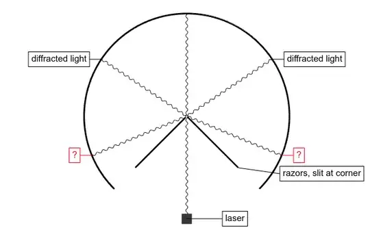

This leads to a question I don't know the answer to. Suppose you could build your slit with, say, two razor blades mounted on micrometers so you could get the distance just right. And suppose you could put the razor blades at a 90 degree angle to each other, so the wall the slit is in is not flat at all. Can diffraction bend light more than 90 degrees? I'm not sure what the theory says about that. And I haven't heard that the experiment has been done.
