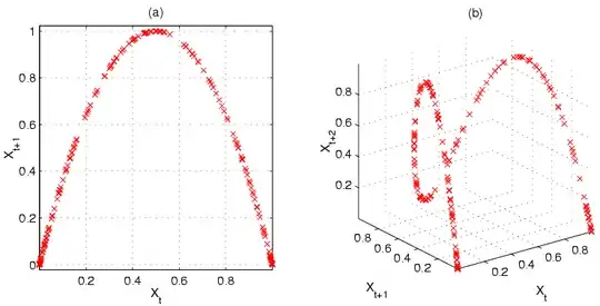

  • a Poincaré plot is (for 1-D systems) a plot of, e.g., $x_{n+1}$ against $x_n$, i.e., for a trajectory $x_0, x_1, x_2, x_3, ...$ the Poincaré plot will be 2-D with points $(x_0,x_1), (x_1,x_2), (x_2,x_3), ...$;

Now, with this trajectory in hands, you can obtain plots (by hand or software) such as the Poincaré plot for $r=4$ displayed in the Logistic Map's Wikipedia entry:
https://upload.wikimedia.org/wikipedia/commons/c/c1/Logistic_map_scatterplots_large.png
For a different parameter value, you'd obtain a different plot. A 3-D plot with axes $r$, $x_{n+1}$, and $x_n$ would also be a possibility.

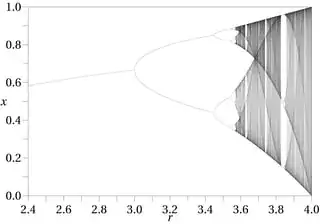

The logistical phase portrait is simply a segment of line, $x_n \in [0,1]$. It can show which parts of it are more densely populated by trajectories, and a 2-D plot of $\{x_n\}$ as a function of the parameter $r$ is known as a bifurcation diagram. Again from Wikipedia:
https://upload.wikimedia.org/wikipedia/commons/5/50/Logistic_Bifurcation_map_High_Resolution.png

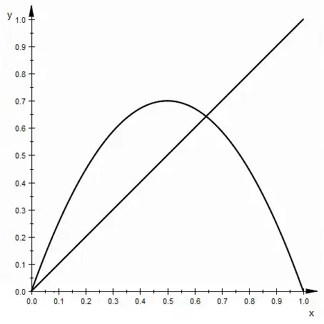

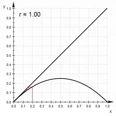

Also worth of mention, for 1-D maps at least, is the cobweb plot, which is essentially a graphical representation of the iteration process that is very useful for gaining an intuition about the process. Wikipedia examples use precisely the logistic map:
