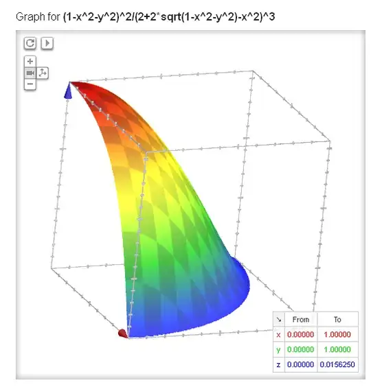

I also wanted to verify (or refute) the claim that an angular momentum causes the black hole to radiate more slowly. I graphed the part of the equation for the Kerr-Newman black hole with the special units for charge and angular momentum. Neither of these can be zero, so I graphed from 0 to 1 for the range of both. The maximum value of the plot is exactly $240/15360=0.015625$.
Google graph
So yes, any amount of charge and/or angular momentum decreases the rate of Hawking radiation.
