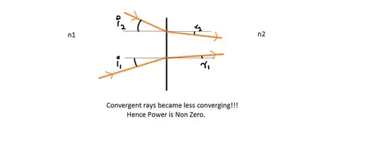

Now if we consider an plane interface between two different media. Let converging light rays pass through it from denser to rarer. Then the rays become less converging. That is negative power. But according to the above formula ,we should get power as zero(Since R=infinty for plane interface). Why do I get a different answer? Can anyone make out the mistake I did?
As shown in the above figure, Power is non zero. But the formula suggests that power is zero. Why?
In this example there is only one interface for which the lens makers formula, ignoring any particular sign convention, is $$\frac{n_1}{u} + \frac{n_2}{v} = \frac{n_2-n_1}{R}$$ where the object, distance $u$ from the interface, is situated in a material of refractive index $n_1$ and the image, distance $v$ from the interface, is observed from a material of refractive index $n_2$ and the radius of the interface is $R$.
Now if it a flat surface, $R=\infty$, the right hand side of the equation is zero which gives $$\frac u v = (-)\frac{n_1}{n_2}$$ which you might recognise as the real $(u)$ and apparent $(v)$ depth formula which is discussed here?
