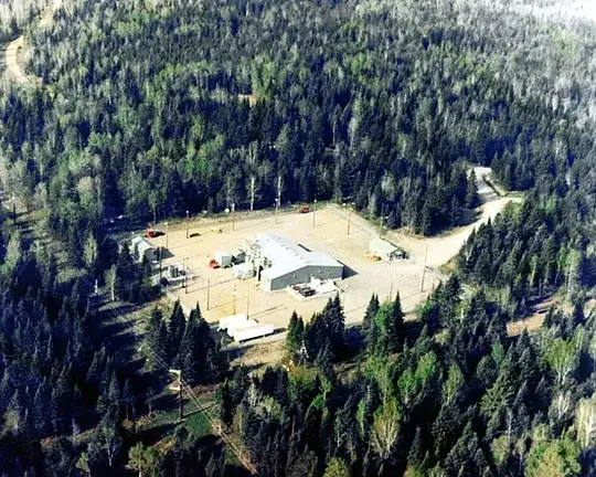

V.F. mentions the relationship between antenna size and frequency, but I'd like to make that more obvious.
This is an antenna that signals at 76 Hz. It is used to send messages to submerged submarines. The antenna is the part in the lower left, do you see what appears to be power lines running through the forest? Well that's one end of it, the other end is 14 miles away.
This is why we try to use high frequencies when we can. Low frequencies have their uses, but it doesn't make for a very practical cell phone.
