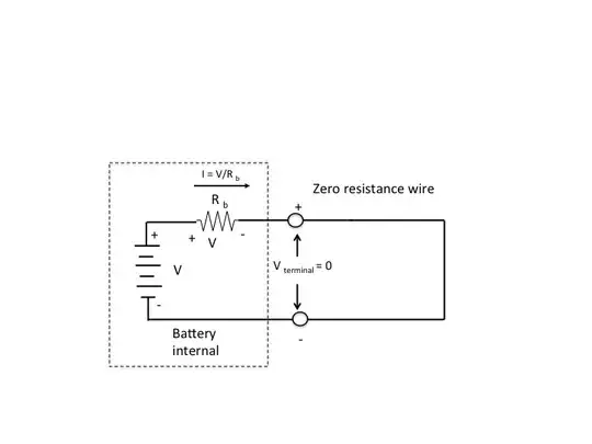

First of all, there is no such thing as a wire with zero resistance. But let’s say there is. But any real battery has internal resistance. See the diagram below. Connected to the battery is a wire with zero resistance. Note that the current that flows in the wire (short-circuit) results in a voltage drop across the internal resistance equal to the internal electrical potential developed in the battery. The voltage across the battery terminals and thus the wire is then zero.
Hope this helps
