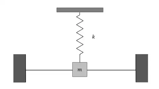

A bead is oscillating in horizontal direction as shown in the figure, our aim is to find the angular frequency of the oscillating bead
First, we can write the potential as: $$V(l)=\frac{1}{2}k\cdot l^2 $$ here $\quad l=\sqrt {x^2+l^2_0}\ \ - l_0 \quad$ then: $$V(x) =\frac{1}{2}k\cdot \left(\sqrt {x^2+l^2_0}\ \ - l_0 \right)^2 $$ Taking the second derivative of this: $$V''(x)= \dfrac{k\left(\sqrt{x^2+l_0^2}\left(-x^4-l_0^2x^2\right)+\left(x^2+l_0^2\right)^\frac{3}{2}\left(2x^2+l_0^2\right)-l_0^3x^2-l_0^5\right)}{\left(x^2+l_0^2\right)^\frac{5}{2}}$$ our equilibrium position on $x$ direction is $x_{eq}=0$ plugging this into $$ \omega = \sqrt\frac{V''(x_{eq})}{m}$$ gives: $$ \omega = \sqrt\frac{V''(0)}{m} = 0$$ It seems a bit silly because it looks obvious that it should oscillate with a nonzero angular frequency. Is there any way to find this angular frequency?

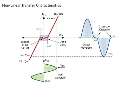

I'm reminded of a BJT class B push-pull circuit where there is so-called crossover distortion as one transistor 'turns off' and the other transistor 'turns on'. The voltage transfer curve is quite non-linear in this region but quite linear elsewhere.
Image credit
Thus, small amplitude sinusoidal input signals are highly distorted by this circuit but the distortion content of the output rapidly decreases as the input amplitude increases.
