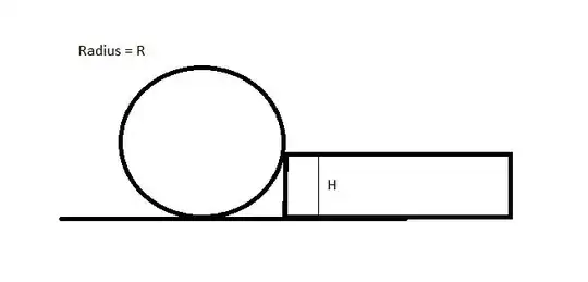

Imagine you are biking, and you come across a ledge. I want to figure out what minimum velocity do you need to bike at to overcome a ledge, of some height $H$.
Roughly, it looks something like this: enter image description here
The wheel is essentially a thin ring, with mass $M$, radius $R > H$, velocity (moving rightward) $v$, and angular velocity $\omega$. We know that the wheel is purely rolling so $v=\omega r$, as long as it is on the rough surface.
I know that energy at the bottom has to be more than the gravitational potential energy of the wheel at the top (the limiting case is when the wheel has no velocity when it mounts the edge). Therefore, $$\frac{1}{2}I\omega ^2 + \frac{1}{2} Mv^2 = MgH$$ where $I$ is the moment of inertia.
I do not think this all you need to know, though. As in you could be going really fast, but a bike won't be able to climb the Empire State Building. Can we conserve angular momentum about the point of contact between the ledge and the wheel? Does the normal force do any work on the wheel? How do you go about finding the minimum velocity required to climb the ledge?
