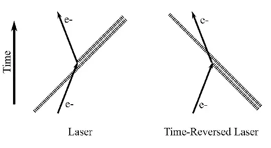

The 2010 Yale paper title also uses the name "Coherent Perfect Absorber", which is arguably more descriptive. "Time-reversed laser" is a sort of cute name that comes from the Feynman diagram for the electron-photon interaction inside the device. Feynman diagram, time up, showing an electron emitting a photon and recoiling in a laser, and an electron absorbing a photon and recoiling in a time-reversed laser.
On the left, inside a normal laser an energetic electron gets hit by an incoming photon, and emits a second coherent photon by stimulated emission--the basic amplification process of a laser. Reversing the time axis shows an electron absorbing a photon, which is the basic absorption process in a coherent perfect absorber. The time reversal analogy isn't perfect for several reasons: the second photon is ignored instead of stimulating the absorption, the second input beam to cancel any leftover photons isn't shown, and a truly time-reversed electron would be a positron!

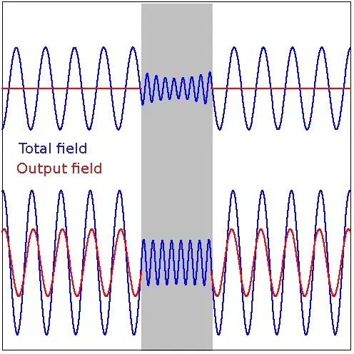

Like a laser, this absorber works with coherent light only, and the optical effects are happening inside a volume, which allows for good efficiency at high power levels.
What is the mechanism for feedback.
A coherent perfect absorber has negative amplification, resulting in an exponential decrease of light intensity. This is a sort of negative feedback, terminating at zero.

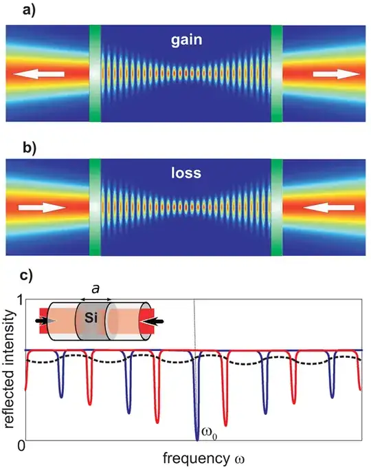

Does this device have modes, does the feedback select an absorption width that narrows? The claims of an absorb band corresponding to the visible range (200nm-800nm) is a rather broad range that is characteristic of mostly everything?
I suspect for good performance, the length of the cavity needs to be an integral multiple of the absorption wavelength, which is the exact analog of longitudinal modes in a laser. Regarding the wide bandwidth, there are "ultrabroad bandwidth" lasers with similar bandwidth ranges, typically femtosecond pulsed lasers, often used for optical coherence tomography.
