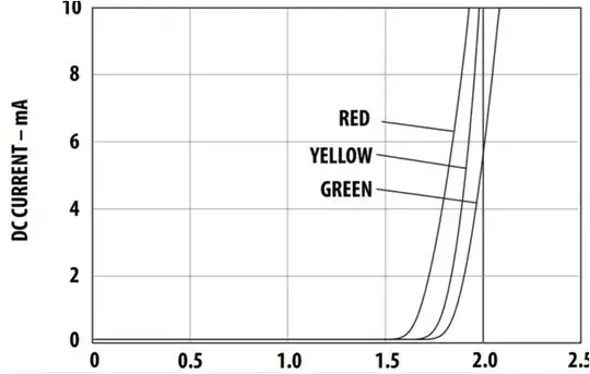

As an example, the diagram below shows typical IV curves for LED's.
In most practical applications, the current for these LED's would be somewhere between $4$mA and $8$mA, a $2$x range, which corresponds to the forward voltage change of less than $5$%, which may create an impression that the current does not depend on the voltage. Yet, the same IV curves show that at $1$V, the LED current is measured in microamps.
In summary, the current of a diode does depend on the forward voltage, but, since the relative change of the forward voltage is typically much smaller than the relative change of the current, we can approximate the forward voltage as a constant voltage drop, which would depend on the type of a diode and on the current range for a given application.
