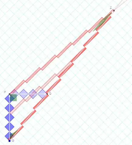

It helps to think geometrically, with a spacetime diagram.
I've drawn one on rotated graph paper so that we can more easily count the tickmarks.
RRGP rotated graph paper time dilation
Observer Alice (RED) moves with (4/5)=PQ/OP according to Bob (BLUE). Each light-clock-diamond counts as "2 ticks".
Referring to your original problem, OQ=6 along Alice's worldline has an apparent elapsed time of 10 according to Bob. Bob uses OP on his worldline to measure the elapsed time of OQ on Alice's worldline because Bob says P and Q are simultaneous.
This sets up a right-triangle OPQ in spacetime, with right-angle at P and OQ is the hypotenuse and OP is the adjacent side. Trigonometrically, $$\frac{OP}{OQ}=\frac{\rm adjacent}{\rm hypotenuse}=\cosh\theta,$$ where $\theta$ is the Minkowski-angle between OP and OQ. Physically, $\cosh\theta$ is time-dilation factor $\gamma=\frac{1}{\sqrt{1-v^2}}$. (The velocity is $v=\tanh\theta$.)
Thus, the first equation in your problem is $$OQ\cosh\theta= \stackrel{?}{OP}$$ where you specified the hypotenuse $OQ$ and $v$ (implicitly $\theta$), and the adjacent side $OP$ is unknown.
That is, "What would Bob say is the apparent elapsed time of OQ (the adjacent side of OPQ) , if Alice says OQ=6 (the hypotenuse of OPQ)?"
To "reverse engineer" the problem, you have to use the same triangle OPQ since you are interested in $OQ$. So, by algebra, the reverse engineered equation is $$\stackrel{?}{OQ}= \frac{\stackrel{\checkmark}{OP}}{\cosh\theta}$$
That is, "If Bob knows "the apparent elapsed time of OQ" (as measured using OP, where Bob says P and Q are simultaneous) [the adjacent side] is 10, what would [the hypotenuse] OQ be?"
Your error is that you have set up the analogous problem for right-triangle triangle OZP, where Alice is trying the measure the apparent time of OP on Bob's worldline using OZ on her worldline. Alice says Z and P are simultaneous.
That is, "What would Alice say is the apparent elapsed time of OP (the adjacent side of OZP) , if Bob says OP=10 (the hypotenuse of OZP)?"

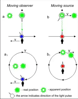

Please find transverse Doppler Effect diagram below:
