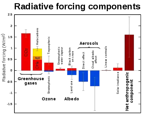

Simple back-of-the-envelope calculation:
This figure shows our best estimates of the radiative forcing from different anthropogenic (human-caused) phenomena:
Radiative forcing figure
It shows that the radiative forcing from anthropogenic $\mathrm{CO_2}$ is the largest component at approximately $1.5 \,\mathrm{W/m^2}$.
The total world electricity generation is approximately $25000$ TWh/year. This is approximately $2.9 \,\mathrm{TW} = 2.9\cdot 10^{12} \,\mathrm{W}$ . The toal surface area of Earth is approximately $510 \,\mathrm{million \,km^2}$, which is $510 \,\mathrm{trillion \,m^2} = 510\cdot 10^{12} \,\mathrm{m^2}$. So if the ratio between heat produced and electricity generated was $1$ for all electricity production, the radiative forcing from this would be:
$$ \frac{2.9\cdot 10^{12} \,\mathrm{W}}{510\cdot 10^{12} \,\mathrm{m^2}} = \frac{2.9}{510} \,\mathrm{W/m^2} \approx 0.0057 \,\mathrm{W/m^2} $$
Now, efficiencies for commercial photovoltaic panels currently does not go much higher than $20\%$, so if we want to do a worst case calculation for a scenario with only solar panels at current total electricity generation, we might want to use a heat-electricity ratio of $5$. This gives $\sim 0.03 \,\mathrm{W/m^2}$. This is still a factor of $50$ smaller than the radiative forcing from anthropogenic $\mathrm{CO_2}$ at current levels.
Conclusion:
This was just a simple calculation to show that heat from electricity generation is a negligible contribution to global climate change, even if we change all electricity generation to photovoltaics. And this calculation doesn't even bother to take into account that photovoltaics don't absorb all light, that the surface they are placed on also absorbed some light, or that many alternative sources for electricity (most notably fossil fuel combustion and nuclear power) also generate heat. If we did that, the net radiative forcing from switching all electricity generation to photovoltaics would be even more negligible.
