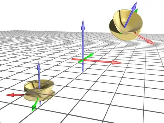

Let's define a $Y$ axis and an $X$ axis that go through the object.
enter image description here The image is just an example to show what I mean by defining the axes.
You prod the right side of the object with a stick, so that it rotates entirely around the $Y$ axis. Every part will be in motion except the center of mass, around which the entire system will rotate.
Now you stop the object from spinning, make sure its still in space once again, and now prod it with a stick near the top, so that it rotates around the $X$ axis instead.
What assures that the point that will remain still, the point that the entire system will spin around, the center of mass, will be the same as when the object was rotating around its $Y$ axis?
