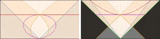

Not the physical constants, but the local observers. You can transform into coordinates where the comoving observers are lorentzcontracted relative to clocks and rulers that are stationary relative to one specific observer.
You can even transform the usual flat Minkowski metric into an expanding hyperbolic metric by choosing local observers that fly away from each other and who are lorentzcontracted relative to stationary clocks and rulers.
The coordinates in which the space expands use hypersurfaces of constant proper time since the big bang (left), and in coordinates in which the comoving observers contract the time runs slower farther away (right).
In cosmology the natural choice are FLRW coordinates like those on the left in which the universe is isotropic and the coordinate time is the proper time since the big bang.
In radar coordinates like those on the right the density is larger farther away, and the red hypersurface of constant proper time since the big bang is hyperbolically bent up due to the time dilation and lorentzcontraction. The far away galaxies that fly faster aged slower and have stronger lorentzcontraction in such coordinates.
proper vs static coordinates
In an accelerated universe, like ours is most likely (with dark energy or any other equation of state where the corresponding density equivalent falls slower than with 1/a²), the comoving observers would shrink more and more the farther they get due to their acceleration, and you can only describe a part of the spacetime with radar coordinates since a ruler which is static relative to a specific observer could only have a finite length before it would get torn apart. In the De Sitter limit in which our universe will end up this would happen at the Hubble radius, which in that case is also the event horizon.
The Milne universe (low density limit) in the FLRW and radar coordinate spacetime diagram above is exactly at the limit between accelerated and decelerated, in that case the static metric in which the galaxies are lorentzcontracted is exactly Minkowski. In the FLRW coordinates the proper radius is infinite, while in the static frame its radius is simply the time since the big bang times the speed of light while the galaxies at the particle horizon are, in the limit, infinitely loretzcontracted.
For our universe where we have a mix of at least 3 different equations of state (radiation, matter, dark energy) the transformation between FLRW and radar coordinates unfortunately is not that elegant, if we want to do that farther away than in our direct neighborhood we need to integrate numerically, at least as far as I know.
