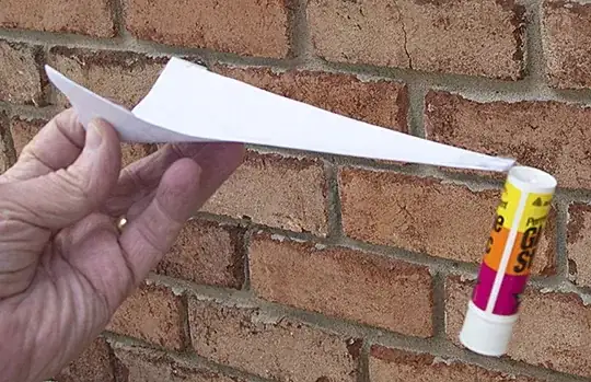

Paper is an extremely flexible material
This is true, but only in one direction at any given time. When you curve paper across a single axis it adds a massive amount of stiffness to the other axis. See SHUKHOV'S HYPERBOLOIDS and how this uses double curvature strengthening. It is best shown in this picture taken from the article.
Illustration of double curvature strength: A piece of paper shaped like a pizza slice supports a cantilever load when it's forced to bend in double curvature. (Photo by John Lienhard)
My guess is that the majority of paper cuts will happen when there is some amount of curvature on the axis that is normal to the cutting edge of the paper. When the curvature is parallel to the cutting edge, the paper will simply bend more.

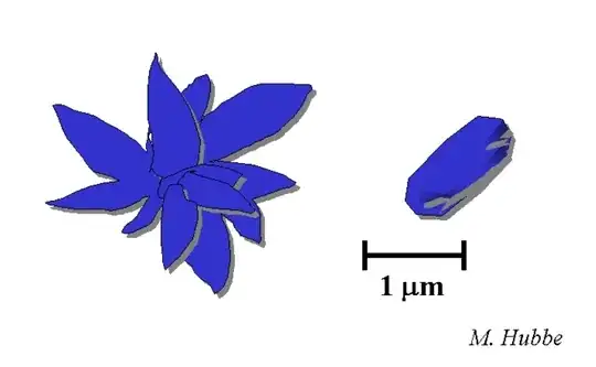

Paper contains filler particles. These are microscopic “knives” - see for example this picture (Precipitated Calcium Carbonate, from this paper)
When paper is freshly cut, such particles (CaCO3, TiO2, ...) are exposed on the edge. They act like any serrated blade, cutting and removing small amounts of material as you slide the edge along a surface (like your finger...). Many of these together can “eat” enough of your skin to make a cut.
