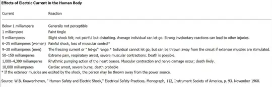

Second, the effective resistance of a screwdriver-indicator should be much greater than $2000ohm$: $70mA$ current could be lethal. Below is a table copied from this OSHA site, which shows the effect of human body exposure to various current levels for $1$ second:
