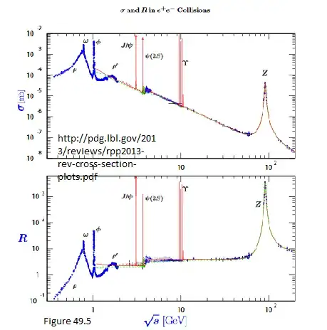

They can go into one massive particle , as seen in this experimental plot of e+e- scattering:
e+e-
but there exist no stable particles, just resonances that decay, some in several channels. The positronium is a bound state atvery low energy for a while, of e+e-, forming an atom, before the e+e- annihilate into two photons.
