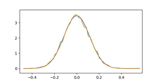

And we could verify this easily enough with a bit of ugly Python (see Appendix), plotting the PDFs of analytical vs numerical solutions: PDF of analytical vs (Euler) numerical sol'n to the SDE

Analytical vs numerical PDF of the original SDE:

plt.plot(xx, norm.pdf(xx, 0, np.sqrt(1./alpha*(np.exp(2*alpha*N*dt) - 1))), xx, yy)
