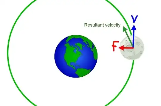

For example, consider the motion of moon around the earth.
The force of gravity is pulling the moon down. But, instead of falling directly to the ground, it revolves around the earth. Why?
Because the resultant velocity is the vector sum of the initial velocity and the Force acting on itm As shown in the figure below.
So the velocity is shifted towards the force. This happens again and again, keeping the moon in orbit.
This happens because the Force acted is perpendicular to the velocity .

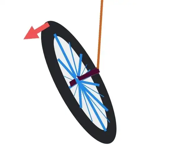

When the wheel is released, the force of gravity applies a torque on the wheel.

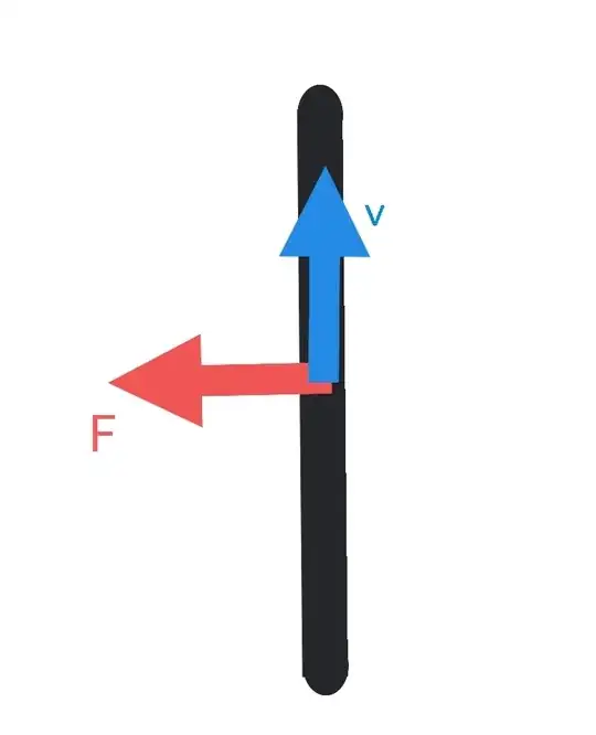

The effect of this torque is like two forces acting on the opposite ends of the wheel, one downwards and one upwards but both perpendicular to the radius.
This is what you see if you look from above:

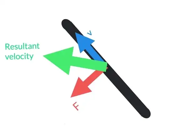

The force is perpendicular to the velocity.
Guess what will be the direction of the resultant velocity?
The resultant velocity is the vector sum of initial velocity and the applied force. This applies to all the particles in the wheel hence the wheel turns in that direction
This happens again and again making the wheel move in a circle.
