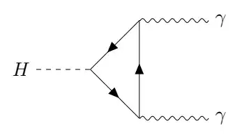

However this does not explain how the Higgs can decay into two photons since those are massless particles and therefore should not couple to the Higgs since this only represents the first order interactions. To higher orders also the interactions of the first order decay products have to be taken into account. If these decay products have an electric charge (like quarks for example do) they couple to the photon. This leads to the Higgs having an effetcive coupling to the photon via virtual loop particles.
As feynman diagram the decay of a Higgs particle into a photon looks like this:
Higgs decay into two photons
The triangle is a loop of virtual particles which basically can be every particle that has a mass and therefore directly couples to the Higgs boson. The condition that $m<\frac{1}{2}m_H$ does not apply for virtual particles (however the sum of the masses of the final state particles cannot exceed the mass of the Higgs but of course for photons this is the case...).
