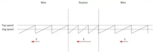

Let's assume that the average speed of an electron should be the same everywhere in the circuit, including wires and resistors. This is generally not true (for instance, when the diameter of a wire changes), but is a reasonable simplification.
If we track an individual electron, we'll, presumably, see that it speeds up due to the electric field, then it collides with an atom (ion), loses its speed and its kinetic energy (which is turned into heat energy) and speeds up again.
If we assume that the frequency of the collisions in a resistor is greater than in a wire, then, given the same electric field (i.e., the same acceleration), the average speed of electrons in the resistor would be lower than in the wire, so the electrons will pile up at the front end of the resistor and will be at deficit at the back end, which will increase the electric field inside the resistor.
As a result, the electrons inside the resistor will accelerate faster, so that, even with the increased frequency of collisions, they will have the same average (and top) speed as the electrons in the wire. Since the frequency of collisions has increased and the kinetic energy loss (heat gain) associated with each collision is the same (due to the same top speed), the heat generated by each passing electron per unit length in the resistor will be greater than in the wire.

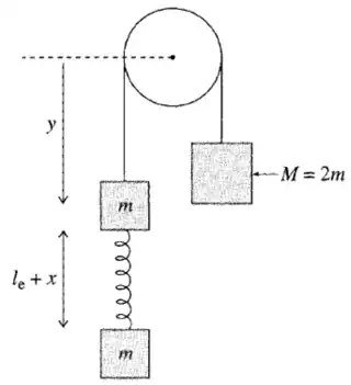

Potential energy of a spring
The potential energy of this spring is visually clear in the suspended weight. If you think that this weight could be a bucket of sand, you can take sand from it and little by little use (in your favorite way) the potential energy of the sand, throwing it on the ground. The spring relaxes little by little, losing its potential. This bucket of sand attached to the spring, however, is an ideal that the battery cannot achieve, as there is always a finite resistance between the poles, even if enormous. It's like there's a small hole at the bottom of the bucket. If its resistance is considerable, we can think of a considerable hole in the bucket. In fact, the figure I am suggesting is well represented by the sand clock below, which is a beautiful analogy, as it highlights the relationship between entropy (degradation of energy) with the passage of time.
Its multiple resistances in series could also be seen as a multi-stage sand clock, with the sand falling into a sphere below which, in turn, also has a hole and causes the sand to fall into another container below. Unfortunately, I didn't find a ready-made figure of a "composite sand clock", but I'm sure you get the idea.
