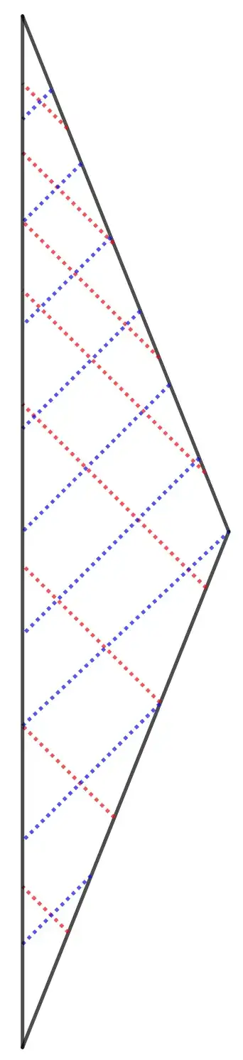

Look at the diagram below.
This diagram is drawn in the reference frame of Bob. The vertical black segment represents 10 days of his life. The croocked black line is Alice's worldline, who is also inertial for most of the experiment, except where the line is kinked, which is the instant in which she turns on her thrusters to reverse directions.
The blue dotted lines indicate the propagation of the Bob's laser's flashes. You can see 9 of them, because the laser's flash on day 0 and 10 coincide with the start and end of the experiment.
The red dotted lines indicate the the propagation of Alice's laser's flashes. I did the maths to make sure that each flash is emitted after 24h as measured from Alice's clock. You can see 8 of them. The ones on day 0 coincides and 9 coincide with the start and end of the experiment.
If you focus on Alices's worldline, you can understand what she sees Bob doing. During her first leg, her laser flashes 5 times, while she receives only 4 of Bob's laser's flashes, including the one at the start of the experiment. Indeed, her first leg lasts 4.5 days for her, and during this time she only sees Bob doing 3 days worth of stuff. If she would be able to watch him, she would indeed see him going in slow-mo. During her second leg, which also lasts 4.5 days from her perspective, she receives 7 of Bob's flashes, the last one being emitted at the moment she reaches him. Thus, if she were to observe him during this time, she would see him do 7 full days of activity. She would see him moving faster than usual.
What does Bob see? You can stare at the picture to convince yourself of the following. He receives in total 8 flashes from Alice, 5 from her first leg (including the one on day 0), and 5 from her second leg (including the one on the last day). But he receives the first 5 over the course of 6 of his days, and the second 5 in just under 4 days. Thus he sees Alice living 4 days in slow-mo, and 5 days accellerated.
Qualitatively, the same thing is happening for both of them: they first see their twin moving too slow, and then too fast. Quantitatively, the situation is slightly asymetrical, because in the end of the day, between their two meetings, Alice has lived 9 days while Bob has lived 10.
