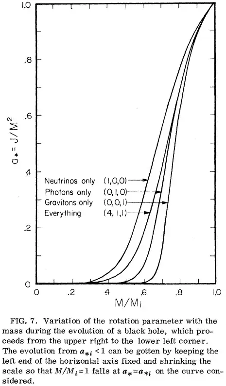

First, rotating black holes. These objects are as close to an ideal axisymmetric system as possible. And all effects of deviation from axial symmetry during black hole collapse would be decaying exponentially within several Schwarzschild crossing times (interval $r_s/c$) since its formation. Nevertheless there are several mechanisms through which it can lose its angular momentum: Penrose process, Blandford–Znajek process, black hole superradiance all allow extraction of rotational energy of Kerr black hole by interacting with a nearby matter. But even if there are no outside fields/matter that could initiate such processes, there is Hawking radiation. Rotating black hole loses angular momentum due to Hawking radiation several times faster than it loses mass, so that it would spin down almost completely before it loses most of its mass. This was discovered by D. Page in 1976:

Here is a figure from the paper describing how the black hole rotation parameter $a$ changes with mass during its evaporation.
Image from paper by D. Page
Of course, now that we know that neutrinos have nonzero masses the Everything curve should actually be between Photons and Gravitons curve.
