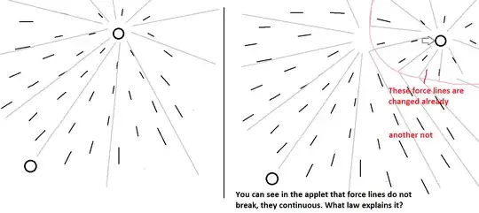

When you launch this applet you can notice, that in the beginning the force lines are propagating from a charge, with some speed(speed of light, probably).
The force lines means, that in every point of the space there are force with straight-defined direction, according to charge position. When charge is changing it's position, the force direction and density should change too.
So, how does a classic physics describes the electric charges forces propagation speed?
