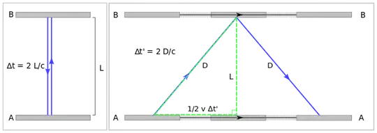

I thought I had understood special relativity, at least the idea of the clocks with light pulses and rods from the book The Meaning of Relativity. But going through the basic illustration of the time dilation made me think otherwise.
I don't get one idea in this illustration. What is confusing for me is this sentence: "Keeping the speed of light constant for all inertial observers, requires a lengthening of the period of this clock from the moving observer's perspective".
I have understood that the axiom of special relativity is that the if a pulse of light is reaching the observer's frame of reference, then he would measure the speed of this light as c irrespective of the speed of the source (thinking about the Michelson-Morley experiment). However, in this illustration, the pulse of light they are talking about is the pulse travelling along the line D in the picture. This pulse never reaches the observer.
Then how can one invoke the original special relativity axiom in this context?
Let's give the observers names to make it easier to sort out what is happening. Olivia is the observer in the left-hand figure in your link, and Sarah is the observer in the right-hand figure in your link.
Olivia is using a single clock to measure the time needed for the light to travel along path $D$. Sarah is using two clocks, both stationary, one located where the pulse is generated and the other located where the pulse is received.
Sarah's location in her reference frame isn't entirely relevant, but we can suppose she is located at the position of the first clock, where the light pulse was emitted. She receives a signal transmitted from the second clock, where the light pulse was received. That signal records both the time of reception and the position of the second clock. Sarah then knows the distance between the clocks in her frame, and compares the timestamps to get $\Delta t$ in her frame. (Note that it is not necessary that the speed of the transmitted signal be the speed of light, although we usually imagine that it is.)
The light doesn't have to 'reach the observer' in order to be observed. There's a (vast) difference between seeing and observing within Special Relativity.

The measurement of the speed of light along the path $D$ is (conceptually) made with rods and clocks at rest in that inertial reference frame moving with respect to the light clock.

Forget about observers altogether. The idea of observers is totally unnecessary and often a cause of misunderstandings.
The speed of light is the same in every inertial reference frame, regardless of whether or not anyone observes it.
In the frame of the light clock, the light travels vertically up and down the clock. In the frame in which the clock is moving, the light travels on a longer angled path. Given that the light travels further in the second frame than it does in the first, the time interval between the departure and the return of the light must be greater in the second frame than in the first. Ergo time dilation. No observers are needed.
