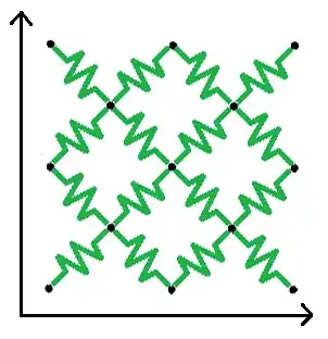

So, suppose you have a system that can be represented like this, directions to be stretched are represented by the axes:
spring1
Then the coefficients in the x and y axes are obviously independent of each other. and might have different values, and so are the components of force.
However if the system represents something like this:
spring 2
Then it is not so obvious that they are independent.
To simplify, suppose I have one spring with coefficient k, positioned diagonally with respect to axes. $$\vec F=k\Delta r \hat r = k\Delta r(\frac{\Delta x}{\Delta r} \hat x + \frac{\Delta y}{\Delta r} \hat y) = k\Delta x \hat x + k\Delta y \hat y $$ So, the components of force can be separated with having the same effective coefficient k as the original, on both components. And this can be applied to a system of combination of springs, just like above, which can represent a sheet of fabric, that is assuming there is zero or minimal shrinkage or contraction in between when stretched on opposite sides.
