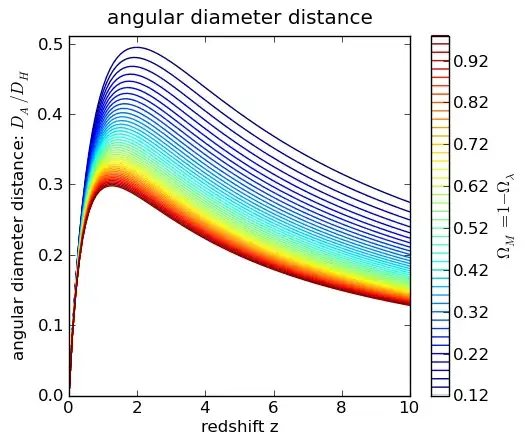

This optical effect is explained by the Angular Diameter Distance decreasing with distance in an expanding universe, whether open, closed, or flat:
The smaller the angular diameter distance, the larger the object appears in the sky. Therefore, galaxies of the same size should appear the smallest in the sky at the redshift of about $z\approx 1.5$. The galaxies that are closer to us should naturally appear larger, because they are closer, but, counterintuitively, the galaxies that are farther away from us also should appear larger due to the optical effects of the space expansion. Thus the universe should act as a giant telescope magnifying distant objects the more the further they are.
