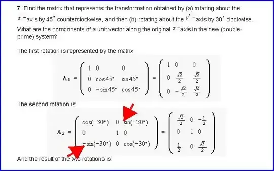

After a careful look in above equations we note that in the cases of rotation around $\;x_1,x_3\;$ [equations \eqref{eq02.1},\eqref{eq02.3}] the term $\;\boldsymbol{+}\sin\theta_\jmath\;$ is up-right while the term $\;\boldsymbol{-}\sin\theta_\jmath\;$ is bottom-left. But in the case of $\;x_2$, equation \eqref{eq02.2}, we have the inverse : the term $\;\boldsymbol{+}\sin\theta_3\;$ is bottom-left while the term $\;\boldsymbol{-}\sin\theta_3\;$ is up-right. In this difference lies the error in Susan Lea, see Figure below (page extracted from $^{\prime}$Student Solutions Manual for Mathematics for Physicists$^{\prime}$ by Susan Lea)
The corrected matrix $\;\mathbb{A}_2\;$ must be \begin{equation} \mathbb{A}_2= \begin{pmatrix} \cos\left(-30^\circ\right) & \hphantom{-}0 & -\sin\left(-30^\circ\right)\vphantom{\dfrac12}\\ 0 & \hphantom{-}1 & \hphantom{-}0 \vphantom{\dfrac12}\\ \sin\left(-30^\circ\right) & \hphantom{-}0 & \hphantom{-}\cos\left(-30^\circ\right)\vphantom{\dfrac12} \end{pmatrix} = \begin{pmatrix} \hphantom{-}\frac{\sqrt{3}}{2} & \hphantom{-}0 & \hphantom{-}\frac{1}{2}\vphantom{\dfrac12}\\ \hphantom{-}0 & \hphantom{-}1 & \hphantom{-}0 \vphantom{\dfrac12}\\ -\frac{1}{2} & \hphantom{-}0 & \hphantom{-}\frac{\sqrt{3}}{2}\vphantom{\dfrac12} \end{pmatrix} \tag{03}\label{eq03} \end{equation}
