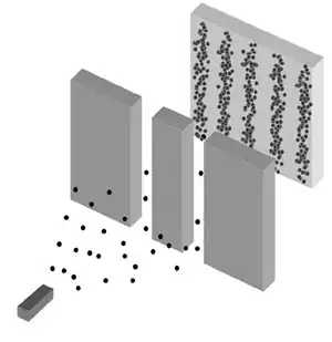

Suppose I have the following double split experiment set up:
  • a monochromatic electron source of low intensity, which we can model as emitting a single electron at a time with energy $T$.
  • a diffraction screen at a distance $A$ with two macroscopic slits equidistant from the source with width $w$ and distance from the center of the screen $\frac{d}{2}$.
  • a detector screen sitting parallel to the diffraction screen at a distance $B$ which consists essentially of a lattice of ammeters each connected with a square surface of side $r$.
                                 Double slit experiment
Classical quantum mechanics, and experiments, tell us that the following behaviour is experienced:
  • Only one random ammeter is disturbed each time an electron is fired
  • The probability distribution of the random ammeters being fired is as given by QM.
The interaction of the electron with the detector is not modeled, the electron is essentially modeled as a wave with interference and which ammeter is fired, essentially an effect of particle behaviour, cannot be discussed within this picture.
So, the measurement or decoherence of the electron wave function corresponds to this switch between wave-like and particle-like models of the electron - which is clearly unsatisfying, intellectually, because QM is vague about this - it merely associates mathematical operations with the procedure, without giving any particular physical or mathematical justification of it.
