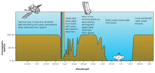

@Kyle Kanos is correct, there is a "Radio Window":
Opacity of the Earth's atmosphere
allowing ground based operations.

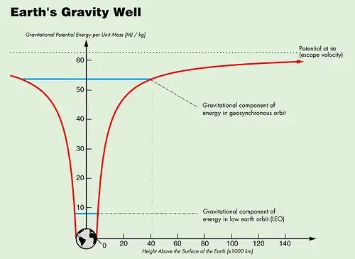

This is a graph of gravitational potential energy for different orbits:
Earth's Gravity Well, potential energy vs orbit height
The Moon would be up above geosync, around the 60 mark but a way off to the right.
