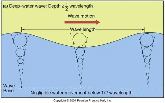

This is what normal wave motion looks like. enter image description here
Do tsunamis that travel at 60mph look any different?
Dale
  • 6,150
The period of a tsunami is long (say about 30 minutes), so the wavelength of that wave is about 30 miles, much longer than the depth of the deep ocean (about 3 km).
And out on the ocean, speed is like that of a jet liner, about 800 km/h.
So tsunamis are shallow water waves, with a speed given by $v= \sqrt{g \lambda}$, even in the deep ocean.
