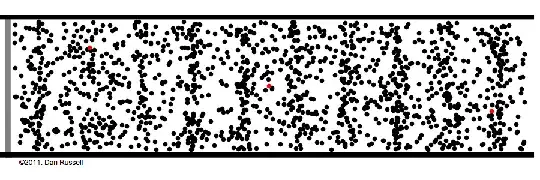

Then, the speed of sound in the metal is given by
$$ v_s = \sqrt{\frac{Y}{\rho_m}}, $$
where $\rho_m$ is the density of the metal. Sound is a longitudinal wave, meaning its oscillation is in the same direction as its motion. See the below gif.
Connecting these, you can show that the speed of sound within the solid is
$$ v_s = \sqrt{\frac{k_{\rm s,i}}{m_{\rm atom}}}d. $$
