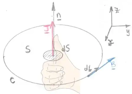

There is a convention linked to the right hand set of xyx-axes which is used when evaluating integrals of the type which occur in one of the equations that you have quoted.
$$\oint_C \boldsymbol{H} \cdot d\boldsymbol{L} = \int_S \boldsymbol{J}\cdot d\boldsymbol{S}$$
The diagram shows a current density $\boldsymbol J$ passing through an area $dS$ whose normal is $\boldsymbol{n}$ so $\boldsymbol{J}\cdot \boldsymbol{n} \,dS= J\,dS$ and when this is integrated over the whole area $S$ this gives the enclosed current.
And he then says that this is defined by the right hand [grip] rule.
The sign of the line integral will change depending on the direction of the path (anticlockwise or clockwise).
The convention is that in this case the anticlockwise direction (looking from the top) is chosen using the right hand grip rule the reference vector direction being the direction of the normal to the surface $\boldsymbol n$.
So it is $\boldsymbol B \cdot d\boldsymbol L = B\, dL$ which is integrated taking the anticlockwise path $(+B\,2 \pi r)$.
