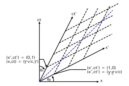

To measure time actually means to measure the time interval between events. According to a stationary (inertial) frame, a moving (inertial) frame will have the spacetime axes rotated by a hyperbolic angle - in such a way that the speed of light remains constant for both frames.
You can see geometrically that the time interval between two events will not be the same in both frames because of that rotation. So the time is not literally ticking slower for moving objects in the sense that they experience everything in slow motion, what happens is that the time interval between two distinct events is greater for a frame that is moving relative to an observer than it is for that observer.
