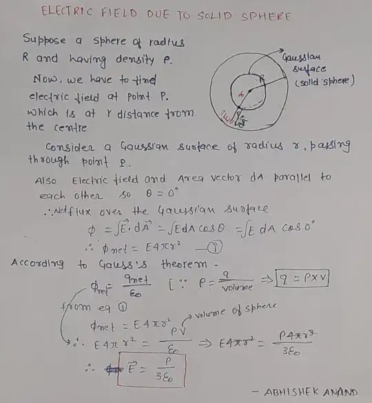

$$E= \frac{kQr}{R^3} \\ = \frac{\rho r}{3 \epsilon_0}$$
-3
enter image description hereElectric field due to solid sphere.This is so easy.
