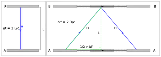

The effect of time dilation comes directly from the central postulates of special relativity, which are that a) the speed of light is the same in all inertial frames of reference, and (b) that the laws of physics are the same in all inertial frames of reference.
Consider an observer inside a railway car. The height to the mirror ceiling is $L$, and he fires a laser to see it go and return. From the definition of velocity, he sees that
$$ v = \frac{dx}{dt} \quad = c = \frac{2L}{\Delta \tau},$$
where $\tau$ is the time he measures. enter image description here
In the frame of reference of someone watching him pass by at speed $v$ (see the picture from Wiki), they similarly measure that
$$ c = \frac{2\sqrt{L^2 + \frac{1}{4}v^2\Delta t^2}}{\Delta t}, $$ where $\Delta t$ the time span in the ground frame. Combining these, you can show time dilation, as given by
$$ \Delta \tau = \Delta t\sqrt{1-\left(\frac{v}{c}\right)^2}. $$
Since we know of the speed limit $ v < c $, the root term is always less than 1, and thus the moving observer measures a smaller time.
This is a physical result. The observers measure different time spans for the light clock, and they are both equally valid in thinking their measured time is "correct". So the effect of time dilation arises directly from the assumptions of special relativity, not from the doppler effect.
