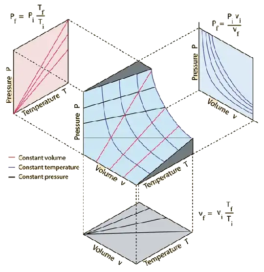

Degrees of freedom frequently come up in statistical mechanics. As a first example, the macroscopic description of an ideal gas requires two variables, usually chosen from the three canonical state variables (temperature, volume, and pressure). Those three variables are related by the equation $PV = Nk_BT$, where $N$ is the number of molecules and $k_B$ is Bolzmann's constant. So the abstract ideal gas, considered as a thermodynamical system at equilibrium, has three degrees of freedom. Here is a visualization of the two-dimensional ideal gas surface in a three dimensional space:enter image description here
On a microscopic level, a gas has many more degrees of freedom. Each molecule has a position which is specified by three coordinates and a velocity specified by three additional coordinates, so there are at least six degrees of freedom per molecule. Furthermore, the molecules can have angular moments and vibrational modes, adding additional degrees of freedom. In a way the object of statistical mechanics is to take a system with a very large number of degrees of freedom and give a statistical description of it with few degrees of freedom. Note that the ideal gas abstraction is only able to predict aggregated statistical properties of a gas, and cannot tell us about the individual molecules, as it contains nowhere near enough information in its two-dimensional state space.
