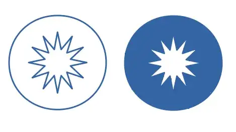

Consider the following figures:hollow and solid shape
Let us assume that this is a section of a cylindrical shape that stretches along the third dimension long enough that the effects of bottom and top are negligible for the overall moment.
We see that most of the mass of hollow shape is concentrated in the star-shaped curve which has a relatively small average distance from the center. While for the solid shape the average distance would be larger.
By simultaneously increasing the number of rays in the star and radius of outer circle (and keeping the overall mass the same) we can make the ratio $I_\text{solid}/I_\text{hollow}$ arbitrary high.
