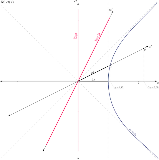

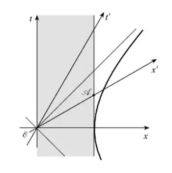

What you've missed is that the distance along the $x'$ axis is not the same as the distance along the $x$ axis. The locus of events that are 1 unit of proper distance from the origin is a hyperbola. This can be used to calibrate the $x'$ axis. See calibration hyperbola.
One picture is worth a 1000 words here... enter image description here

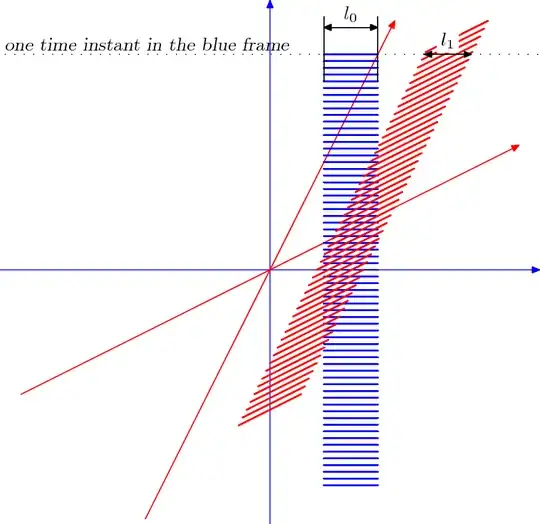

The important point is that we make a snapshot of the moving object in a time coordinate which is not its proper time. Indeed, if we drew just one image of the moving object in a cut given by $t' = \rm const.$, we would get a projection on the $x$ axis longer than $l_0$. But we must use $t = \rm const.$ instead if the measurement is done in the un-primed coordinate system. Thus, we measure the "front" of the object earlier (in terms of its proper time) than the "rear". The difference in $t'$ allows the latter to cover some extra distance, putting the two events closer in $x$. If the math is worked out, it indeed gives $l_1 < l_0$.

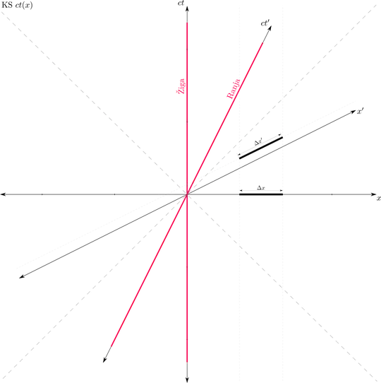

After thinking about aditional options to explain this it returned to me, that in frame $c',ct'$ marks on $x'$ axis are further appart than marks on $x$ axis (pay attention to $1$ and $1'$). So my picture was correct from the beginning, but i didn't draw the marks on $x'$ axis. Thank you Alfred Centauri.
Well now it is obvious why moving observer sees shorter distance. Take a look at the picture and give me some feedback please:
Q: But what if a meter stick is stationary in frame $c',ct'$? I guess then $\Delta x'$ is the proper length and i have to transfer its edge points to $x$ axis using lines parallel to $ct'$ axis?

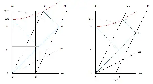

A and B have a mirror M on the end of a rod of length d. In the A frame, the length of the rod is ct=d. The red hyperbola, aka calibration curve, denotes the same A-time where it intersects the time line of a moving observer. Gamma=g. Left: Bt=2gt at the return signal, event D. B assuming a pseudo rest frame (because there is no absolute rest frame), perceives his signal to M as equal out and back, giving d=gct, greater than d. Right: With length contraction, B measures the B rod as ct=d. A measures the length of the B rod as d/g. B measures the length of the A rod (on the Bx axis) as d/g. The results are reciprocal only if the B frame is affected by lc. length contraction
