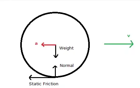

Say a student rolls a tire on a flat level surface. There is no car involved or anything it’s just the tire. As the tire rolls, the tire slows down by friction and eventually comes to a stop. I have drawn an extended free body diagram below in paint.
ROlling wheel with friction: I don’t have subscripts in paint so I just spelled out the words instead of using appropriate labels. And the weight and normal force should be about the same size as the friction force(rubber on concrete coefficient of friction ~1) but ignore that lol
I have the wheel rolling to the right and gradually slowing down with acceleration to the left. Since it is accelerating to the left, then that means static friction must be pointing to the left. So this is the problem: If static friction is pointing to the left, that means friction is also creating a torque on the wheel that points into the screen. If there is a torque pointing into the screen that torque should speed up the wheel’s rotation! But that doesn’t happen. So the question is: How can we use just Newtonian physics (not energy considerations) to account for the fact that the friction force is doing two seemingly contradictory things at once? It’s slowing the wheel down by pointing to the left, but also speeding the wheel up by applying a torque into the screen. I’ve been struggling with this for a few days. I was thinking maybe I’m missing a force, like air resistance. But that shouldn’t matter. We should be able to perform this same experiment in a vacuum. Somehow, there must be some torque applied out of the screen to cause the wheel to slow in its rotations. But I don’t know how.
If there is only single force applied at a single point like in your image, then indeed this will not make the wheel stop both its translation and rotation.
In reality, friction forces act on several points distributed across non-zero contact surface area, not at single points. What happens is that the wheel deforms the ground surface in such a way that pressure is uneven across the contact surface and net torque, being a sum of individual infinitesimal torques due to infinitesimal contact forces, will be such as to slow down the rotation, even while the net force applied at the lowest point of the contact area would not by itself do that.

Imagine a wheel dipped in a soft ground surface like mattress. When it moves, the mattress is deformed unevenly. The contact forces acting on the front part are higher than forces acting on the back. Due to deformation and contact friction, these forces acting on the front do not point towards the center of the wheel, but their line of action goes above that center. Such forces both act to slow down the translation and have torque that counteracts the rotation.
This is an example of mathematical fact that net torque acting on a body is not, in general, torque of the net force acting on that body, as if applied at some point. In general, such "reconstruction" of torque with a single force applied at some point is not possible.
