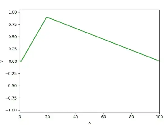

A simple model for a plucked string is the string starting out as a triangle, where the ends are connected to the point that gets plucked. In this animation you can see how this would evolve under the wave equation:
By adding multiple strings being plucked at different positions you see that they repeat after exactly the same time.
Note that any initial wave shape would repeat after the fundamental period.
So does this also apply in practice? In general, no. The oscillation seen in the animation can also be seen as many sine waves added together, each oscillating with their own frequency. In reality the oscillation will be damped and the wave equation will only be followed approximately. Each frequency will be damped by a different amount so the overall shape of the wave changes over time. This means you won't get a simultanuous repetition like in the second animation.
