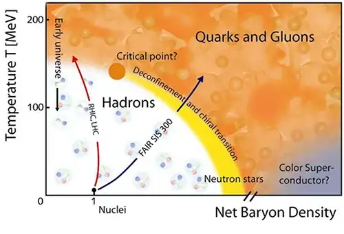

Here is a phase diagram:
Fig. 1: The QCD phase diagram, with a hadron phase of ordinary nuclear matter and a quark gluon plasma phase. [At zero matter (baryon) density the phase transition is established to be a smooth crossover, current research searches for a first order transition and a critical point at finite density.]
It is not simple, and still under study.
This illustrates the first quote.
The second quote is a hypothesis within this model, that reversible processes allowed by quantum number conservation can occur even when temperatures are over the 200 MeV scale. This is logical considering that the average kT is a statistical number which describes uniquely the black body curve which has a variation in individual particle energy that will allow the overlap of baryons created and annihilated to exist in the mix. It is not one fixed value describing all possible interactions, these have to be studied individually.
